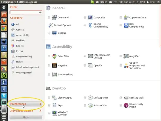

  2. Open Compiz Config Settings Manager and go to Preferences
    Open CCSM from dash
    Preferences

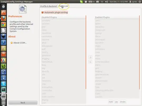

  3. Select Plugin List Tab
    Plugin list
  4. Disable Automatic Plugin Sorting and accept the warning that will appear after trying to disable it.

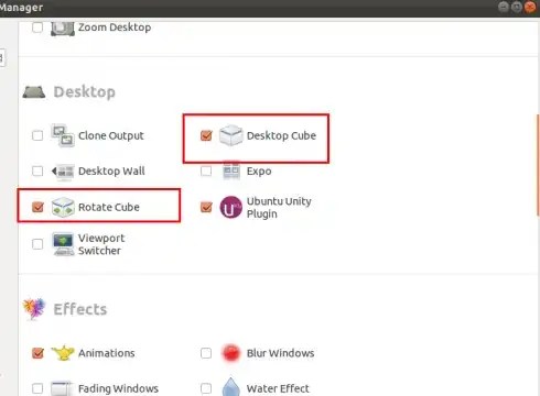

  5. From the Disable Plugins List, Enable the following plugins: cube, rotate
  6. From the Enable Plugins List, Disable the following plugins: wall

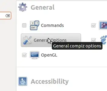

  7. Go back from the Preferences menu to the Main Compiz Menu and select General Options

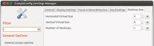

    General options

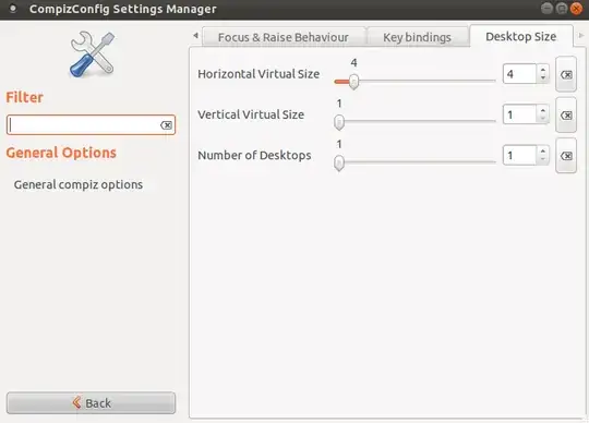

  8. Go to Desktop Size tab and change the Horizontal and Vertical Virtual Size to 4:
    How it looks in 12.04 or below Virtual Desktop Sizes in 12.04 How it looks in 12.10+ Virtual Desktop Sizes in 12.10+
DONE

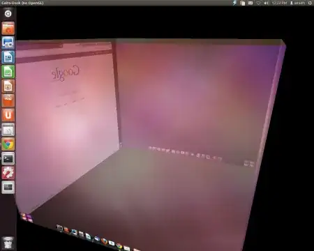

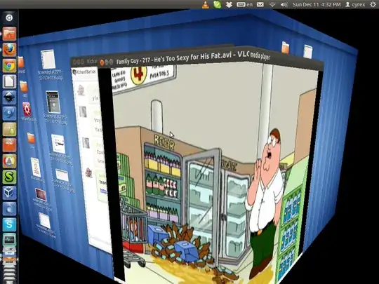

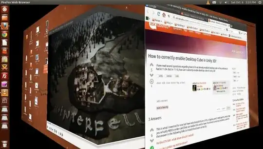

I will need to test it even further to say that it is stable but so far am typing this with the Cube effect activated, could drag a video I was watching to another virtual desktop and no problems.
On 12.04 watching Family Guy
Desktop cube
On 12.10 watching Game of Throne + AskUbuntu
On 13.04 watching (actually crying) Fringe:
Lastly, you can just download My Compiz Profile to import using the CCSM Import option and have the configuration that is mentioned in this post.

  2. Run ccsm, see these screenshots
    Screenshot 1
    Screenshot 2
