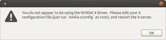

On rebooting, I encountered the following dialog when I ran the Nvidia X Server Settings tool Example 1
I did as instructed and ran sudo nvidia-xconfig, and this is what the /etc/X11/xorg.conf file that was generated looks now->

However I still get the same dialog after I have rebooted.

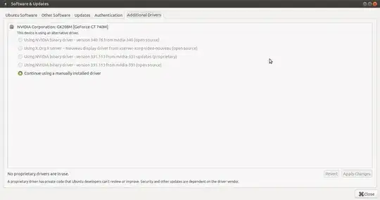

Also, this is the additional drivers dialog, which to me suggests that I am running the new driver:
Example 2
