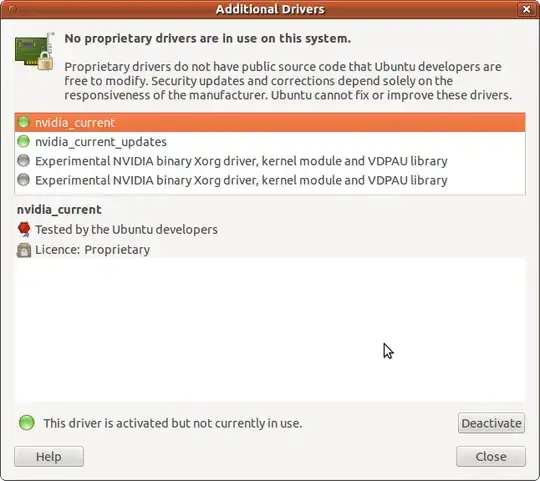

  1. "System Settings > Additional Driver" window has drivers, but the nvidia x server cannot connect/utilize any of the 4 drivers. the drivers are activated, but not in use. enter image description here

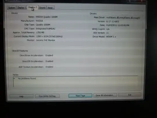

2) (My computer is triple boot) I logged into Win7 and ran 'dxdiag' command. here is the screen shot:enter image description here

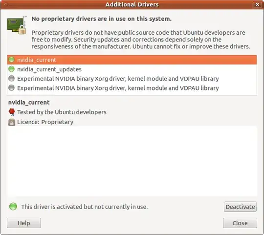

1) I took a screen shot of the "additional drivers" right after generating xorg.conf by nvidia-xconfig. Here it is: enter image description here

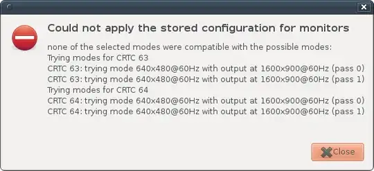

2) Then I did a reboot. Now Ubuntu is 600 x 800 resolution. When I logged in after the computer came up I got an error (which I always get after generating xorg.conf by nvidia-xconfig and rebooting) enter image description here

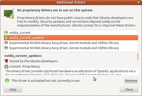

3) To finally answer the question - No. There is no "NVIDIA-304" driver. Screen shot of additional drivers after generating xorg.conf by nvidia-xconfig and rebooting : enter image description here
