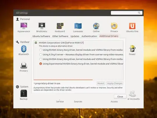

The desktop does not show after I installed nvidia experimental drivers. I tried nvidia simple proprietary drivers, and they did not work either.
Here is how it looks. This is not cropped or any thing. This is how it looks, after the installation of the drivers the desktop resolution decreased from 1440x900 to 1024x768
The desktop only shows desh and panels when I use the open source drivers.
Is there any way to fix this so I can get better performance?
