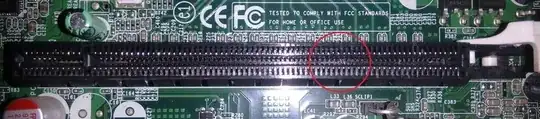

So after 1,5 years of testing it seems I've finally solved this problem. All it took was sheding some light into the issue. Literally.
This is what I was only able to see after putting some bright, direct light into my PCIe slot:
PCIe
I'm guessing this happened when I first inserted my video card into that slot. The card may have pushed a couple of pins upward, shorting the circuit and causing all those freezes.
The only tool I had to reach that narrow space and try to unjam those wires was a pocket knife. I was half desperate, half okay with the fact that I'd have to get another motherboard if I wanted to game in my machine, so I just went ahead and started shoving that knife in there and pushing those wires back and down, to see if I could put them back in their places. I do not recommend this technique.
My technique had everything to go wrong. However, it did work, and my system's been freeze-free for over a month.
