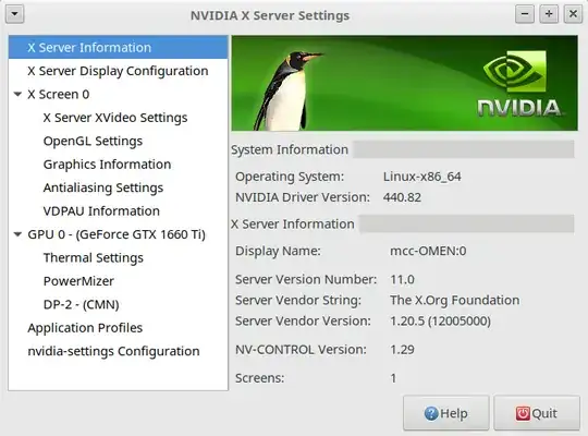

  2. The second is your Nvidia card. If Ubuntu installed properly, which I am guessing it did, Ubuntu should have loaded the 'Nvidia X Server Setting' menu/panel. Usually, the Nvidia software can be found in the control settings panel or just search for 'Nvidia' on your machine. You should get a menu like this...enter image description here Worse come to come worse got to Nvida.com and download the latest and greatest version, better yet just go and check their docs...
