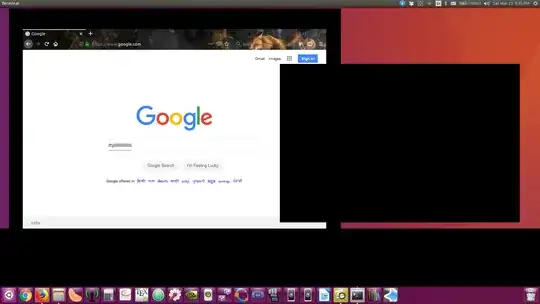

GUI Screenshot
In the above image you'll see that the terminal is just a black box on the right. The black bar just above the unity launcher is the onscreen keyboard which is still responsive, even though it's blackened, which is true of all apps; I can close the terminal (which in the picture is the black box on the right) by randomly clicking in the upper-left corner. The same happens even for drop-downs; clicking on the wifi or the power logo on the menu bar on the top just gives me a black box.
This problem used to happen before and it would be fixed with just a simple restart. Now a restart wont't work. As you can see, I can't use the terminal, and I cant access a lot of things since the GUI will just be blacked out most of the time. I can't use my system like this. Please help.

Here's how I managed to fix the issue:
  • I noticed that unity --reset fixed the issue but also froze my laptop in the process.
  • So I searched for workarounds related to unity and found the following fix (askubuntu.com/a/377460/937306) which I will repost here
Reset compiz settings: dconf reset -f /org/compiz/
Then restart Unity: setsid unity
Using XTerm (an alternative to the Terminal which can be searched on the unity launcher dash) helped a lot. I must also mention I had nvidia driver issues which I resolved later by following How can I uninstall a nvidia driver completely ? and How do I install the Nvidia drivers?
