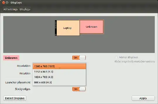

Here are the resolutions offered by the "Displays" system settings. Note that 1280x720 is not listed: Displays setting window

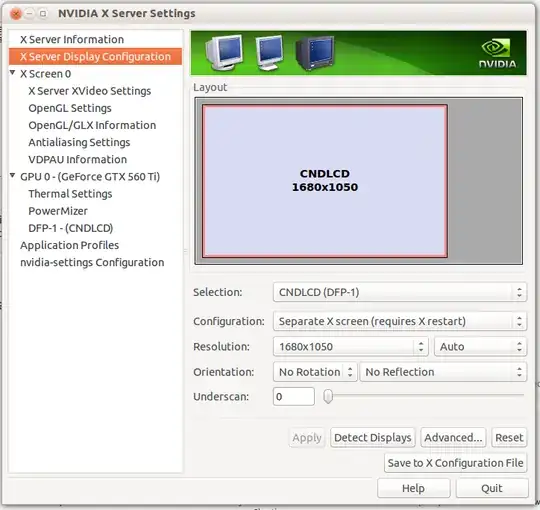

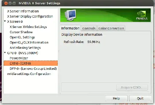

The nvidia-settings program is similarly unhelpful. The "Acquire EDID" option is grayed out:
nvidia-settings screenshot

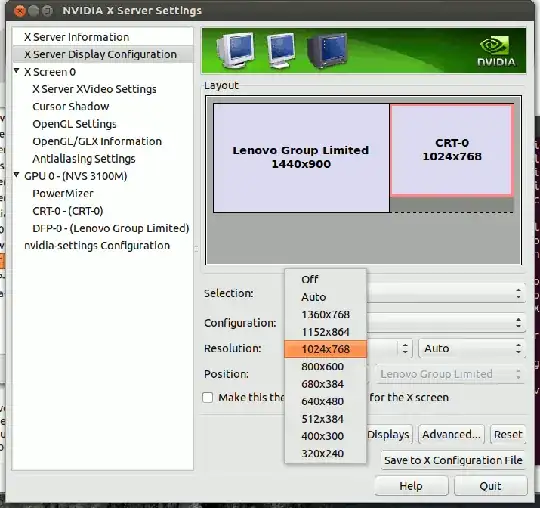

And it also doesn't offer the 1280x720 resolution:

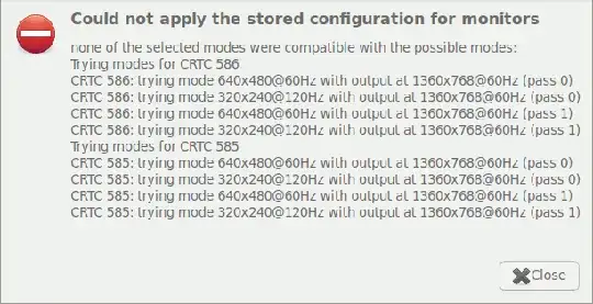

I don't have any /etc/X11/xorg.conf file. I did try running nvidia-xconfig to create an xorg.conf file, but that seemed to make everything much worse: the projector came up only in 640x480, and the mouse cursor would get "stuck" on one of the displays. When X starts with this xorg.conf file, I also get this error message popup box:

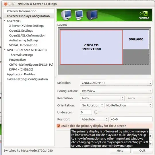

Here is my test case:
I have an Epson video beam and the computer's monitor. Without the video beam it shows like this:

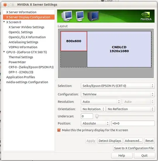

Now, connecting the video beam and clicking on Detect Displays in the Nvidia Display Configuration section shows the following:
I then drag the layout boxes around (The ones that represent the video beam and Monitor) to my liking and resolution. So they look like this:
Make sure you select the one you want to see as default as the Primary Display at the bottom of the options.
