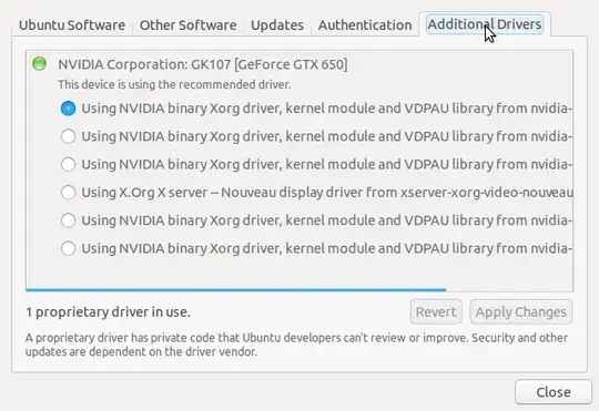

I dont quite understand what your problem is but you can find the nvidia driver for Ubuntu in the Software and updates app (look in the dash) under the additional drivers tab. enter image description here
This is the best way to install, also version 3.10 is recommended as it is most stable.
