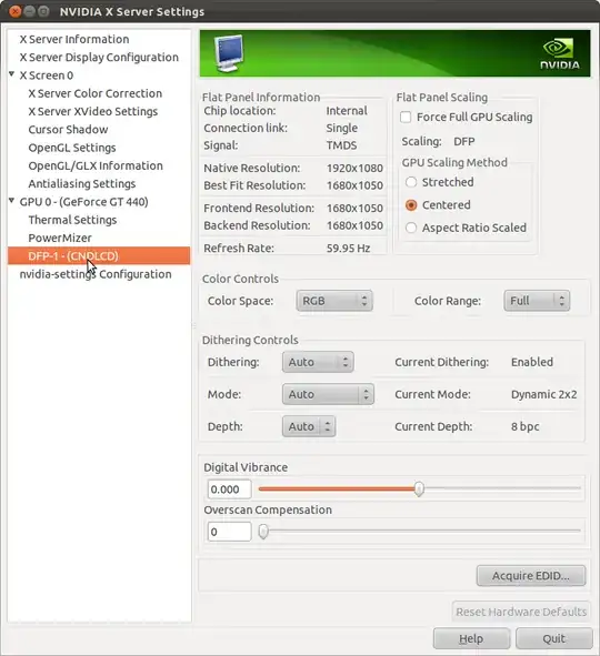

NVIDIA WAY
  1. Go to Nvidia-Settings and there will be an option that will have more features if a HDMI cable is connected. In the next pic the option is DFP-1 (CNDLCD) but this name changes depending on what device the PC is connected to:
  1. Uncheck Force Full GPU Scaling
What this will do for resolutions LOWER than 1920x1080 (At least in my case) is solve the flickering problem and fix the borders cut by the monitor.
  1. Save to Xorg.conf file the changes made after changing to a resolution acceptable to your eyes.

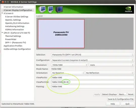

MANUALLY ADJUSTING THE RESOLUTION
If you happen to have one of the newest Nvidia Drivers, then some of the above points will not work. For this cases, Open the nvidia-settings app and go to X Server Display Configuration. Click on Advanced... and change the following options to a resolution slightly lower than the one you are using:
  • Video Port In
  • Video Port Out
  • Panning
Note that the TV I am using does not support 1680x1040. Instead I selected 1920x1080 ad then edited the 3 mentioned options to a slightly lower resolution so I could "move" the X/Y coordinates to see the Launcher Icons and Top Pane. In the Video Port Out option, The 2 values after the resolution are the X and Y coordinates. They will normally appear like 1680x1040+0+0 but after you edit the values and Save the changes you will see the Launcher and Top panel appear. In my case I put 48 for X and 30 for Y. This made the panel and Launcher correctly show in TV (Viewport).
