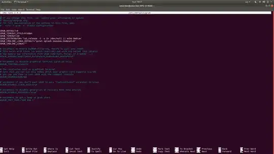

Now,I have problems with suspend mode not working and brightness controller not functioning which is expected. Using e in the grub bootloader and changing nomodeset to nouveau.modeset=0 fixed all of these problems (no blackscreen too), but now I have a new one: I can't seem to remove nomodeset permanently from grub. I was able to add nouveau.modeset=0 successfully, but nomodeset still stays as a boog flag even after using sudo grub-update. What's even more weird is if I view /etc/default/grub in nano, nomodeset isn't shown here, yet it's flag is still present in the grub bootloader when pressing e. Is there any way to completely remove nomodeset from my boot flags? nano shown here
