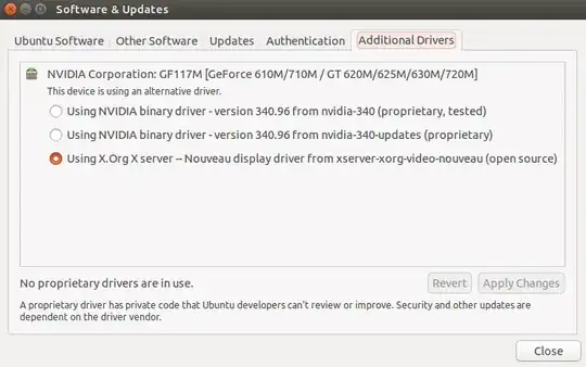

  • Switch to your default driver in Additional Drivers:

This worked well for me : I am using Nvidia GeForce 820M.
Open Software & Updates app in Ubuntu and it allows to install NVIDIA driver from GUI.
