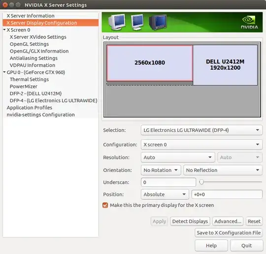

For Nvidia Cards
  1. IMPORTANT: Ensure you're using a display port cable from your PC to your monitor.
  2. Then you need the proper drivers:
  3. After you reboot launch the Nvidia Control Panel from the dash. The latest versions of the Nvidia drivers include native support for 21:9, on my system it just worked:

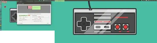

There is nothing to do, it should just work out of the box. Just plug the HDMI cable, and the screen should work.
Please have a look at the screenshot below. enter image description here
On the left, the default 1366x768 screen of the laptop. On the right, the 21:9 screen. See that the resolution and ratio is detected on the display setup.
The laptop is a Lenovo E531, with a Core i5, with integrated Intel GPU. No extra graphic card.
