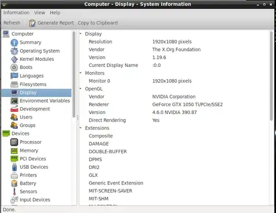

The attached screenshot shows that the NVIDIA 390.87 driver is running my GeForce GTX 1050 Ti card.
I installed this driver from the graphics-drivers ppa thusly:
sudo add-apt-repository ppa:graphics-drivers/ppa
sudo apt update
sudo apt install nvidia-384 nvidia-settings
Note: this is what I did, and 384 is supposedly a transitional package; you may be able to install nvidia-390 directly.
