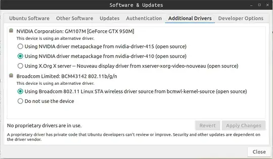

To install Nvidia Drivers:
You can use Software & Updates application where you have to just navigate to Additional Drivers section where you will see something like this
Just select the appropriate version of nvidia driver and click on apply changes after installing the drivers you might need to restart your pc.

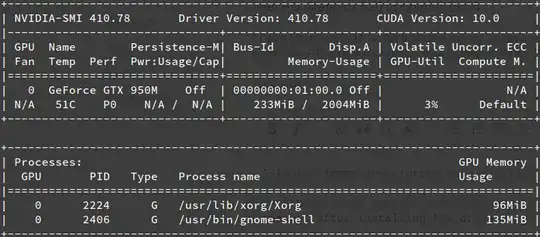

Note: To check if the nvidia drivers are installed or not you can run the following command and you'll see something like this
nvidia-smi

Open the app drawer and search for "drivers", open the app and install the Nvidia Graphics Driver. Just be aware that it will use more battery power.
