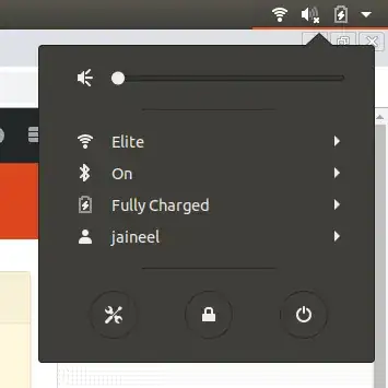

I had dual booted my Dell Inspiron 5577 (NVIDIA Geforce 1050) i5 Laptop with Windows 10 as Ubuntu 18.04. But it appears that there is no option to change brightness in the options from settings of top right corner of screen.
Dash menu screenshot
Function keys for changing brightness (F11 & F12) are not working (other function keys are working fine.)
