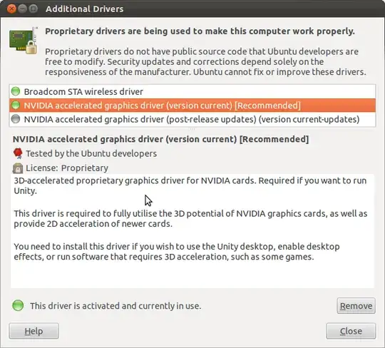

The only way for the moment to have HDMI Audio support in an Nvidia card is by first installing the proprietary drivers and then selecting the HDMI Audio as output.
  1. Install Proprietary Drivers and Reboot PC

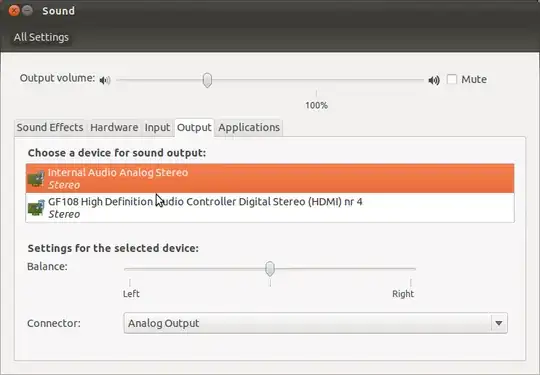

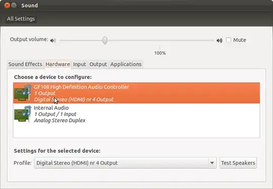

  3. Make sure that in the Hardware Tab you can see the Nvidia card and then make sure that in the Output Tab you can select the Nvidia card. Select the Nvidia Card as the output and you should hear the sound.
This should be enough to have sound in any of the Nvidia Cards that support HDMI Sound.

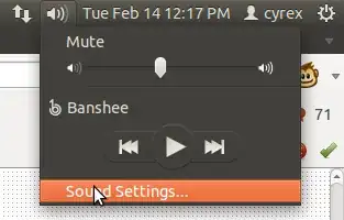

Open the sound settings by clicking the volume applet and selecting "Sound Settings". From there, make sure that under the "Hardware" tab, the HDMI card is selected, as well as under the "Output" tab. That should do the trick
