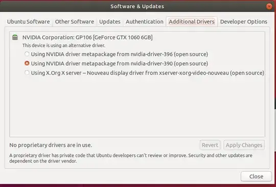

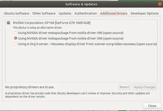

while the additional driver shows that i am using nvidia driver
Don't know what to trust?
