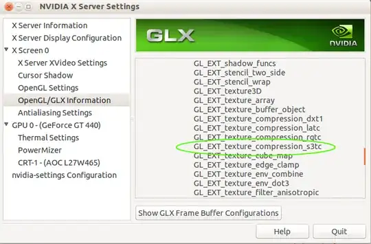

This is just saying that it needs a driver that supports than GL extension. If you had an Nvidia card then installing the latest proprietary ones (The ones that come in the Xorg Edgers PPA) will solve this issue as seen in the following image:
But since you have an Ati then you are doomed... just kidding ^^. Simply do the following steps in order to have full support (This is my quick way of solving video support issues like this):

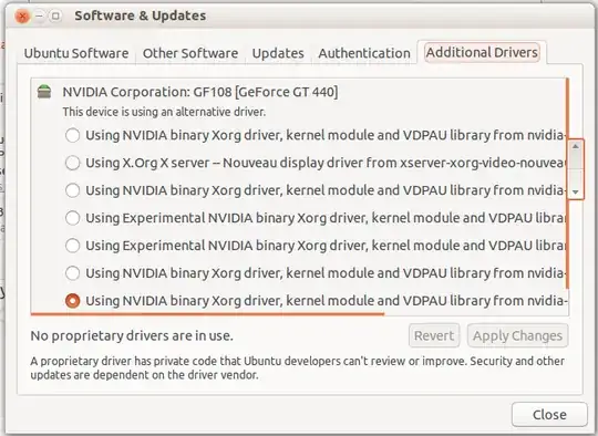

    • Type Software Sources in Dash. Open the Software Sources Window and go to the last TAB that says Additional Drivers. Look for the proprietary drivers for your Ati there. For Nvidia it looks like the following image but it will be the same for Ati (Just imagine all Nvidia drivers mentioned there to be Ati ^^):
