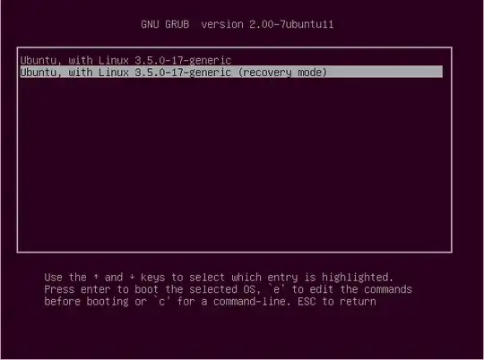

  1. Boot PC leaving SHIFT pressed to make the GRUB Menu show.
    Grub menu

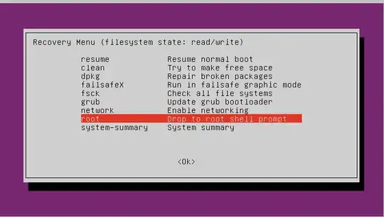

  2. Select Recovery Mode which will continue booting correctly until the Recovery Menu appeares.

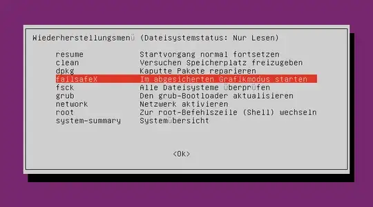

  3. Select from the recovery menu failsafeX.
    recovery menu, yes it's german please replace :( wasn't able to get it in english by changing system language and doing update-grub

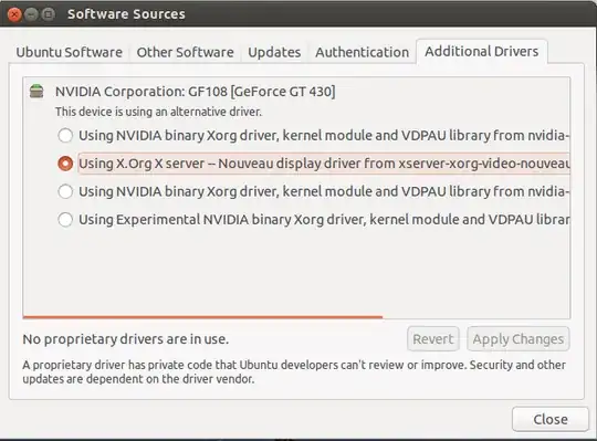

  • If you have a problem with the restricted (closed source) driver , then try to remove it.
Open a terminal and give this command
gksudo software-properties-gtk
Goto Additional drivers and remove the dirver. You have to mark the Using X.Org X server -- Nouveau.
Then Reboot.

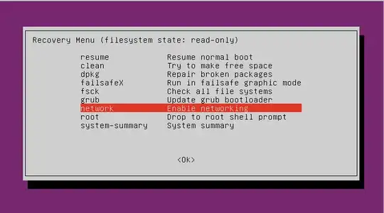

  • If you have not access at all to the Desktop Environment then use the Recovery Mode.
To remove the Nvidia current driver in Ubuntu 12.10
Select the Network and your root partition will mounted as Read-Write.
Select the Root enter image description here
