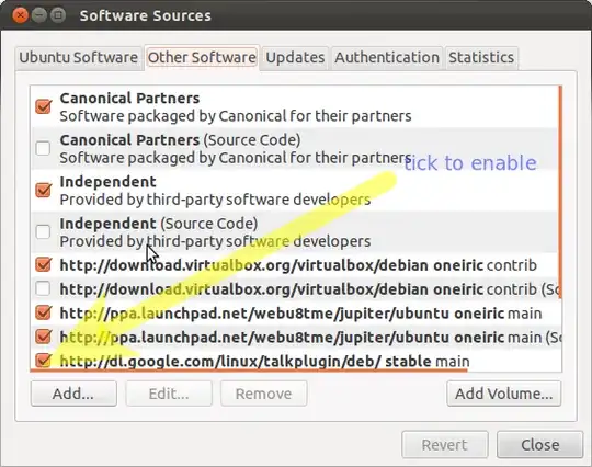

  1. A user has just upgraded and has re-enabled a PPA software-source that no longer exists enter image description here

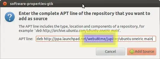

  2. A user has manually typed in a new software source incorrectly enter image description here

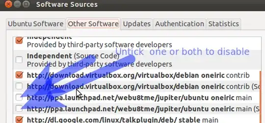

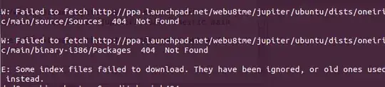

Typically, if you run sudo apt-get update from a terminal or click the details button in Update Manager after hitting the refresh button you will see errors such as:
If the error is due to a PPA - usually unticking the similarly named PPA with the URL shown in the error message will resolve this.
If the 404 error was due to an additional repository that has been added to /etc/apt/sources.list then its easier to add # character to the start of the line to comment out the offending repository i.e.

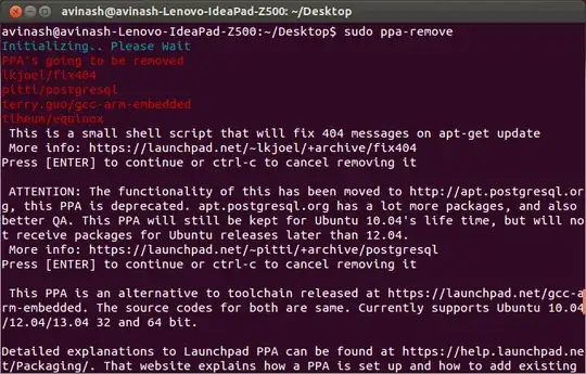

Automated Removal of 404 Not found PPA's through script
This is a script to remove automatically all the 404 Not found PPA's. Copy the below code and paste it into a file and name it as ppa-remove.
#!/bin/bash
sudo rm /tmp/update.txt
tput setaf 6
echo "Initializing.. Please Wait"
sudo apt-get update >> /tmp/update.txt 2>&1
awk '( /W:/ && /launchpad/ && /404/ ) { print substr($5,26) }' /tmp/update.txt > /tmp/awk.txt
awk -F '/' '{ print $1"/"$2 }' /tmp/awk.txt > /tmp/awk1.txt
sort -u /tmp/awk1.txt > /tmp/awk2.txt
tput sgr0
if [ -s /tmp/awk2.txt ]; then
  tput setaf 1
  printf "PPA's going to be removed\n%s\n" "$(cat /tmp/awk2.txt)"
  tput sgr0
  while read -r line; do
    echo "sudo add-apt-repository -r ppa:$line"
  done < /tmp/awk2.txt > out
  bash out
else
  tput setaf 1
  echo "No PPA's to be removed"
  tput sgr0
fi
Give execute permission to the script
sudo chmod +x ppa-remove
Copy and paste the ppa-remove file into /usr/bin directory.So that you can access it from anywhere.
Usage
sudo ppa-remove

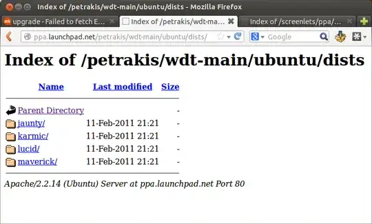

22
You are getting these errors because your PPA repositories don't provide packages for your distribution of Ubuntu (ie; quantal).
Look at the following screenshots:
ppa:petrakis/wdt-main Launchpad logo
wdt-main
ppa:screenlets/ppa Launchpad logo
screenlets
You can see that the directory for quantal is missing and hence you are getting 404 Not Found Error Messages.
To get rid of these messages you have to remove these PPA repositories from your system. Follow this question on how to remove PPAs:
How to investigate this and come to this conclusion?
These are the error messages you receive for wdt-main PPA:
W:Failed to fetch http://ppa.launchpad.net/petrakis/wdt-main/ubuntu/dists/quantal/main/source/Sources  404  Not Found
, W:Failed to fetch http://ppa.launchpad.net/petrakis/wdt-main/ubuntu/dists/quantal/main/binary-amd64/Packages  404  Not Found
, W:Failed to fetch http://ppa.launchpad.net/petrakis/wdt-main/ubuntu/dists/quantal/main/binary-i386/Packages  404  Not Found
Open your browser tab and open the link which gives 404 Not Found Errors. In this case http://ppa.launchpad.net/petrakis/ and go deeper as per the link which gives errors. You would be able to see what the actual problem is.

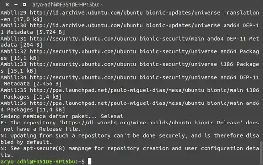

Steps
  1. Do usual sudo apt update after adding PPA/repository. You can notice that there are 404 errors while updating; just ignore this. 404 Error
  2. Open the repository directory which causes 404 error with your browser; in this case it is https://dl.winehq.org/wine-builds/ubuntu. Usually, available releases are located in dists/. Mirrors
  3. After you located it, open Software & Updates, and replace your release name with the available release; preferably latest or LTS one. Replace 'Distribution' section in binary and source code mirrors. In this case, I'm replacing bionic with artful. enter image description here
  4. Do sudo apt update again.
  5. You're done! Now you have no more 404 errors while updating your package lists. enter image description here
  6. When the packages for your Ubuntu version is released, repeat step 3 and 4 by replacing 'Distribution' section with your distribution name.

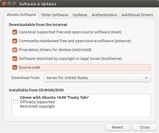

Then open software sources :
sudo software-properties-gtk
You will see 5 check boxes tick them all and underneath change the server to the nearest on to you, for example if you live in the United States you would put the United States server, apply the options and close the window.
