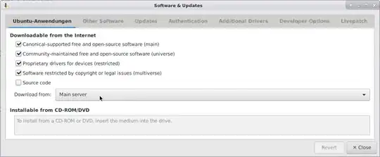

sudo sed -i s,//us.archive,//archive,g  /etc/apt/sources.list
or use
software-properties-gtk
and choose download from main server.
after that
sudo apt update && sudo apt install python-dev
Both ways change the apt sources to main server.
