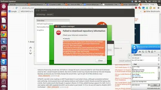

How do I fix this error?
 W:Failed to fetch http://ppa.launchpad.net/deluge-team/ppa/ubuntu/dists/quantal/main/source/Sources  404  Not Found,
 W:Failed to fetch http://ppa.launchpad.net/deluge-team/ppa/ubuntu/dists/quantal/main/binary-amd64/Packages  404  Not Found,
 W:Failed to fetch http://ppa.launchpad.net/deluge-team/ppa/ubuntu/dists/quantal/main/binary-i386/Packages  404  Not Found,
 E:Some index files failed to download. They have been ignored, or old ones used instead.
Error even on Update Manager
The same error occur when I tried,
 sudo apt-get update && sudo apt-get upgrade

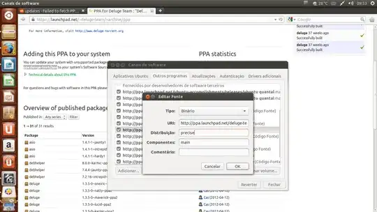

There is no Deluge packages on Quantal, as you can see on Launchpad's PPA page. To use Deluge, you need to edit the Deluge PPA entry to search packages for Precise in software-properties-gtk, changing the Distribution: field from quantal to precise:
Distribution Changing
After that, sudo apt-get update will show no errors about this repository.
