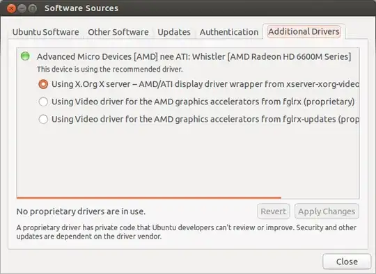

Also: a suggestion: did you check "software settings"/"software sources". I have seen a proposal to add additional driver to that section of Ubuntu. If that made it in you might need to install it from there. This is done by ubuntu-drivers-common.
Found it ...
From my machine:
