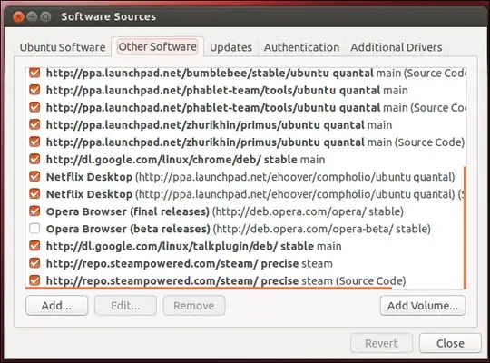

1. Disable the PPA
Please disable (by unchecking or removing) the gwibber ppa via Software & Updates (from Terminal: software-properties-gtk) in the Other Software tab

Alternatively hit Alt+F2 and run software-properties-gtk Software Sources
Click on Other Software tab, you'll see that each PPA have two lines here, one for the compiled packages and one for the source, Uncheck both lines to disable a PPA.Then update your sources list
