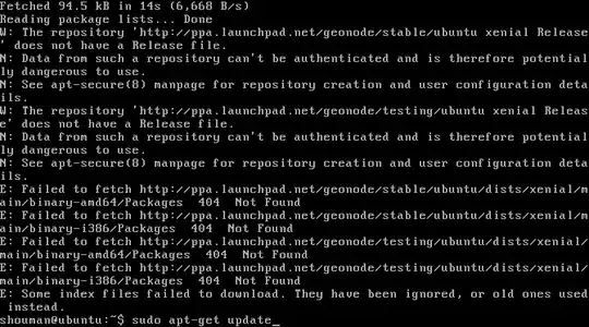

I use Ubuntu Server 16.04 on VirtualBox. I was installing Geonode according to its documentation:
sudo add-apt-repository ppa:geonode/stable
sudo apt-get update
but I have this error:
E: some index files failed to download. they have been ignored or old ones used instead
I can't get the full output because I use VirtualBox but I took a screenshot:
screenshot

The 404 error messages are saying that there is no installation candidate for Ubuntu 16.04. However, I went to check the Geonode PPA in Launchpad and saw that there is an installation candidate for Ubuntu 14.04. Therefore, I suggest you either ask the devs at Geonode's GitHub repo (https://github.com/GeoNode/geonode) to release packages for Ubuntu 16.04 or use Ubuntu 14.04.
If you don't want to see the 404 error messages (they don't harm your system, but they may be annoying), you can remove the offending PPA using one of the many ways given at How can I fix a 404 Error when using a PPA or updating my package lists?.
