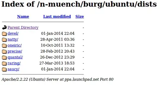

You installed that from a PPA (n-muench/burg/ubuntu) that was intended for older versions of Ubuntu. It seems the PPA maintainer has not made an version for Trusty available in the PPA. Go to Launchpad.net and contact the PPA maintainer directly.

What's happening is that the burg PPA has not been (yet) updated for Trusty (14.04):
