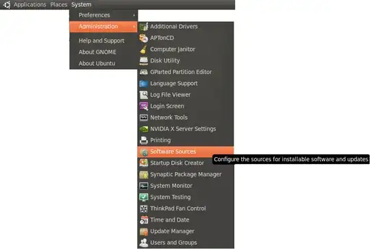

You can manage PPAs in System > Administration > Software Sources or by removing files in /etc/apt/sources.list.d/.

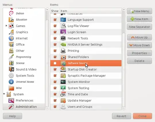

Some people might prefer to add and remove repositories via a GUI. As of Ubuntu 10.10, this requires a bit of extra work. An explanation is available on the wiki. In order to try and have all answers for this question available in one place, I will try and summarize the important details here. Be sure to check the wiki (especially once a new version of Ubuntu is released) to ensure that this process is still valid.
First, you will want to re-enable 'Software Sources' in the System->Administration menu. Right click on the Applications/Places/System menu and click 'Edit Menus'.
Click 'Edit Menus'
This will open a window, scroll down and click on 'Administration'. Check the box next to 'Software Sources' and then click the 'Close' button.
Go to System->Administration and you should see 'Software Sources' in the menu.
'Software Sources' now in menu

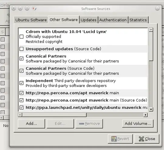

In the window that opens, click on the 'Other Software' tab at the top.
You should see all of the repositories that you have added (including the PPAs added via add-apt-repository). You can temporarily disable a repository by unchecking the box next to it. To remove a repository permanently, highlight it and click on the 'Remove' button. When you are done, hit the 'Close' button.
As Marcel Stimberg noted earlier:
This will remove the PPA from the repository list but if the package is a newer version of one in the standard repos, you have to manually downgrade the package afterwards. ppa-purge (see other answer) does that for you.

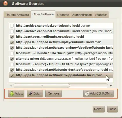

Run Ubuntu Software Center and from the menu choose "Software Sources" - there you can add/edit/remove repositories.

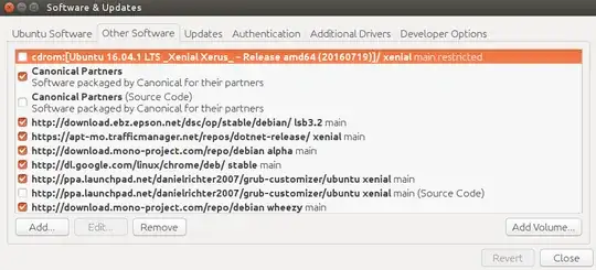

Using Software&Updates
Note: This solution does not remove/downgrade packages associated with the repository.
Search "Software & Updates" (or software-properties-gtk) & launch it then choose tab -> "Other Software". To remove a repository, uncheck it, then click "Close", & lastly "Refresh".

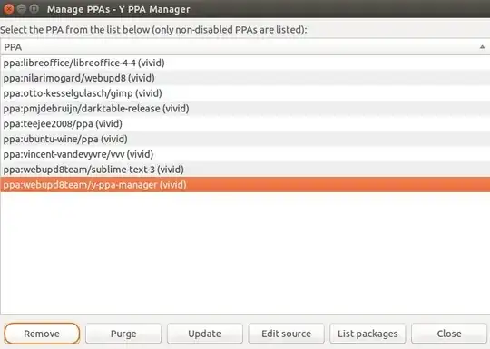

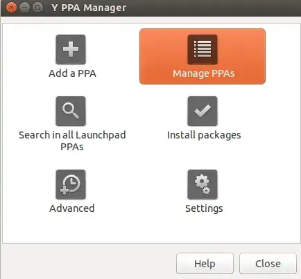

You can use y-ppa-manager
Installation :
sudo add-apt-repository ppa:webupd8team/y-ppa-manager
sudo apt-get update
sudo apt-get install y-ppa-manager
Use :
Open Y PPA Manager and select Manage PPAs
Select the PPA you want to remove and click the Remove button
