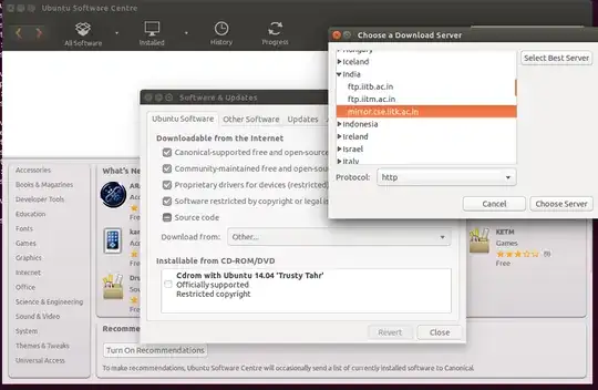

Sound like you may need to chage mirrors and resynchronize the package index files from their sources.
open Ubuntu Software Centre
And choose Edit -> Software Services -> Ubuntu Software -> Download From
Since your current mirror is in India i'm gussing you would like one close to that. Navigate to India -> mirror.cse.iitk.ac.in select the protocol as http
Close Software Centre and then open a terminal and try the below command.
sudo apt-get update && sudo apt-get install openjdk-7-jdk

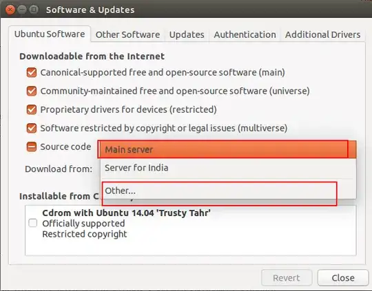

Try changing the mirror Manish.
To do this , go to System Settings -> Softwares & Updates -> Ubuntu Software and select 'Main Server' or 'Other...' to select other mirrors.
If you select Other... option you can select any other mirror other than the Indian mirrors
Ubuntu Softwares & Updates Window
