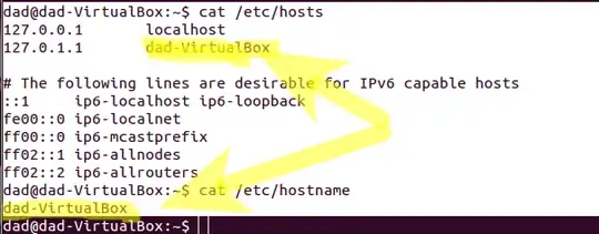

If you change the hostname in /etc/hostname, you must also fix up /etc/hosts so the new name resolves to 127.0.1.1. The safest way is to edit hosts and add the new name, then edit hostname, then o back to hosts to remove the old hostname.
My /etc/hostname and /etc/hosts file is shown - you will need to use your hostname
