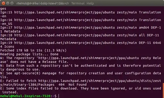

I am getting an error while using the command :
sudo apt-get update
The error:
How can I solve it? since i am new to ubuntu i really dont know much so please help me
sudo apt-get update
The error:
This message indicates that you have added a PPA that doesn't contain a proper file for your Ubuntu version. You can fix this problem by simply remove the PPA that cause the problem (note that no new software will be added), then find the proper PPA location and add it.
To remove a PPA:
sudo add-apt-repository --remove ppa:whatever/ppa
in your case try:
sudo add-apt-repository --remove ppa:shimmerproject/ppa
and then
sudo apt update
