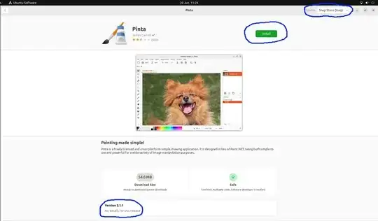

If you want version 2.x of Pinta, you can install it from the Snap Store, either via the terminal:
snap install pinta
... or through the Ubuntu Software app - making sure to pick the Snap Store option and not the deb option if you find multiple results when searching for "Pinta":
Screenshot showing installation via the Ubuntu Software app
Note that installing via the PPA, as suggested by older answers here (and indeed still presented as an option at https://www.pinta-project.com/howto/installing-pinta) will give you version 1.x of Pinta, and merely adding the PPA will display a message recommending that you use another installation approach instead:
