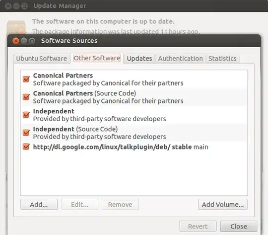

PPAs are additional software sources which are not in default Ubuntu Software Source, so by adding these APPs you can connect you apt-get (software center) to other sources, when these software sources stop their support, this problem happened. so simple just check links if they are correct (have content) you have to find why apt-get update can not detect packages, but when the link is not working (like this case) it means no more support by software makers, in similar cases, simply remove APP link from apt-get as i told you.
here is my source list (as you see, i just have Google as a non-official Ubuntu package source): enter image description here
