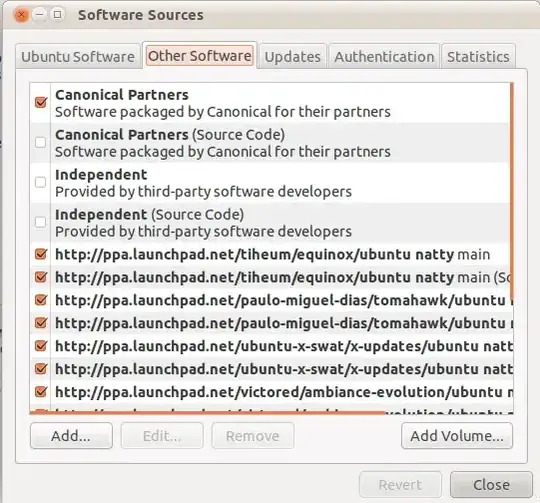

Your have an invalid entry in your sources. It can't imagina how can this happen in a new installation. Anyway:
  1. Open the Software Centre
  2. Click on the Edit menu, select Software Sources.
  3. A new window will open, select the "Other Software" tab
  4. Uncheck everything but "Canonical Partners" and "Independent"
