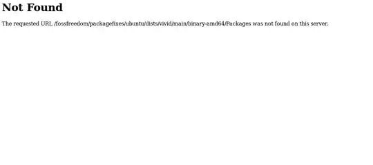

You are getting that error because it's actually so. The URL is currently unavailable.
Here, is a screenshot that says so:

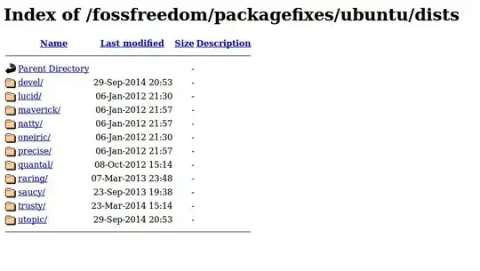

Also, as you can see the parent directory doesn't contain files for your ubuntu version. Screenshot:
It is recommended to wait for a few hours untill the package is reuploaded to the website and then update your system to get the updates.
EDIT: As A. B. said, the application was never released for your version of Ubuntu. So, please remove the ppa or repository.
