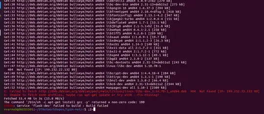

I am getting the following error on running docker-compose -f docker-compose-mssql.yml up -d --build --remove-orphans in my project.
E: Failed to fetch http://deb.debian.org/debian/pool/main/l/linux/linux-libc-dev_5.10.70-1_amd64.deb 404 Not Found [IP: 199.232.22.132 80]
E: Unable to fetch some archives, maybe run apt-get update or try with --fix-missing?
Complete log below:

Err:47 http://deb.debian.org/debian bullseye/main amd64 linux-libc-dev amd64 5.10.70-1
Get:48 http://deb.debian.org/debian bullseye/main amd64 libcrypt-dev amd64 1:4.4.18-4 [104 kB]
Get:49 http://deb.debian.org/debian bullseye/main amd64 libtirpc-dev amd64 1.3.1-1 [190 kB]
Get:50 http://deb.debian.org/debian bullseye/main amd64 libnsl-dev amd64 1.3.0-2 [66.4 kB]
Get:51 http://deb.debian.org/debian bullseye/main amd64 libc6-dev amd64 2.31-13+deb11u2 [2344 kB]
Get:52 http://deb.debian.org/debian bullseye/main amd64 manpages-dev all 5.10-1 [2309 kB]
Fetched 53.4 MB in 2s (22.1 MB/s)
The command '/bin/sh -c apt-get install gcc -y' returned a non-zero code: 100
ERROR: Service 'flask-dev' failed to build : Build failed

I updated the source list to this: https://gist.github.com/ishad0w/788555191c7037e249a439542c53e170 but and able to run apt-get update without any error but the above problem still persist. Please help!
This line in Dockerfile is giving me error: RUN apt-get install gcc -y being not able to find the file linux-libc-dev_5.10.70-1_amd64.deb here, but when I run sudo apt-get install gcc manually it is working as expected without any error.

I had the same issue. For me the issue was that my "apt update -y" step was cached and thus contained wrong repo's. Fixed it by forcing it to not use cache. Looks the same for your step 4 :)
To clear the cache before run use docker builder prune or if that doesn't work (as it didn't for me) try something more aggressive such as docker system prune --all
