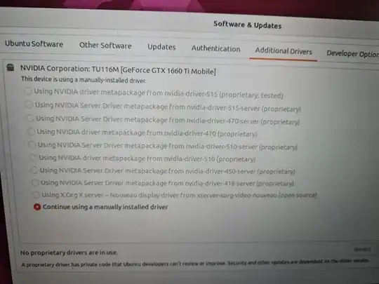

After installing Ubuntu 22.04 ,My nvidia driver not recognized
I try to install them with drivers-devices and it give me error 404 could not fetch.

I solved the problem in two steps.. 1.i change the server from Israel local server to ... ubunto server 2.sudo apt install nvidia-driver-515 nvidia-dkms-515 And that all ...thank you all
