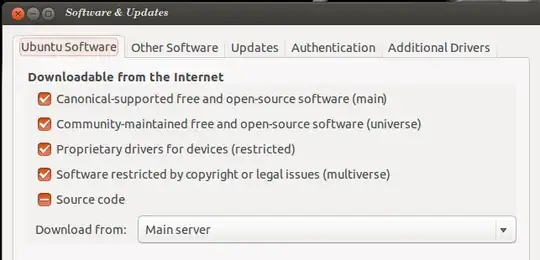

I also faced this type of problem when I choose a custom server for update. If those repository is not available then this type of problem occurs.
First go to dashboard and search for software and updates. Now change the option like this and select download from option to Main Server

Now this will keep you up to date to the main repository. Then try your operation
