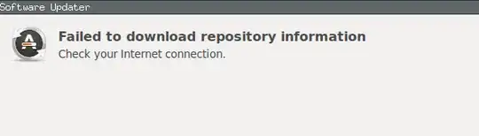

I'm running Ubuntu 14.04, using the i3 window manager. I'm having troubles with the Software and Updates for my system. When I start the update-manager I get this screen :
1_internet fail
The internet is working when I see this, I'm not using a proxy.

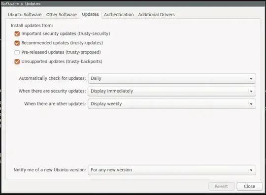

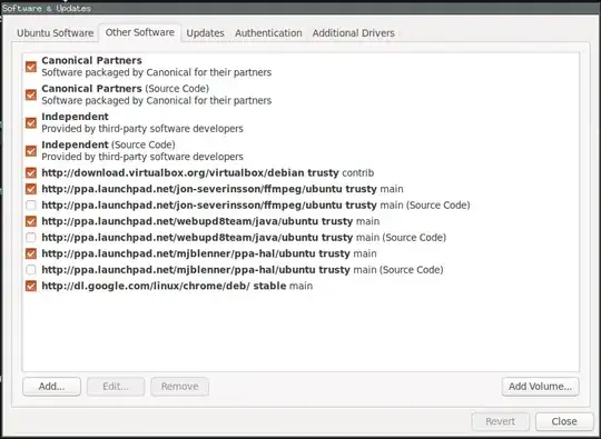

Ubuntu Software
I can't select any of those radio buttons, or at least if I do select one it doesn't stay selected.

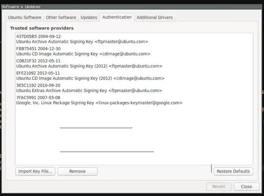

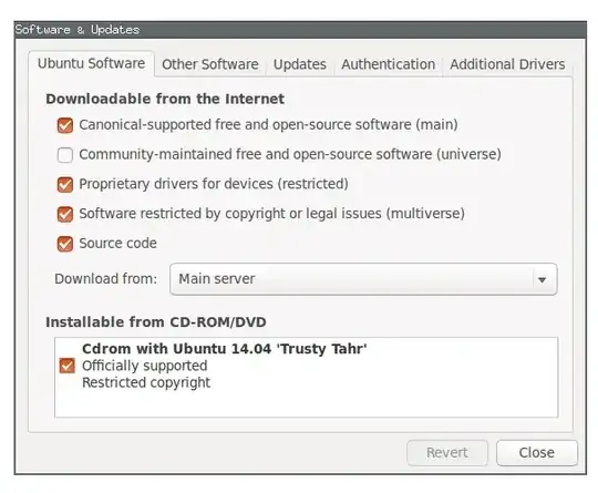

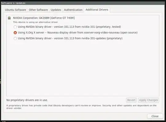

Starting from the left (Ubuntu Software) this is what I have, I can't select any of the radio buttons that are on these pages:
Ubuntu Software
Other software
Updates
Authentication
Additional drivers

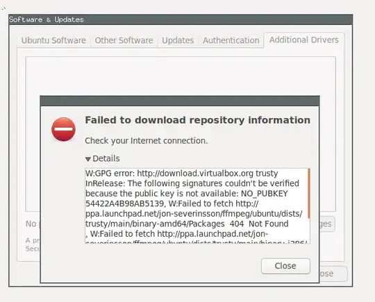

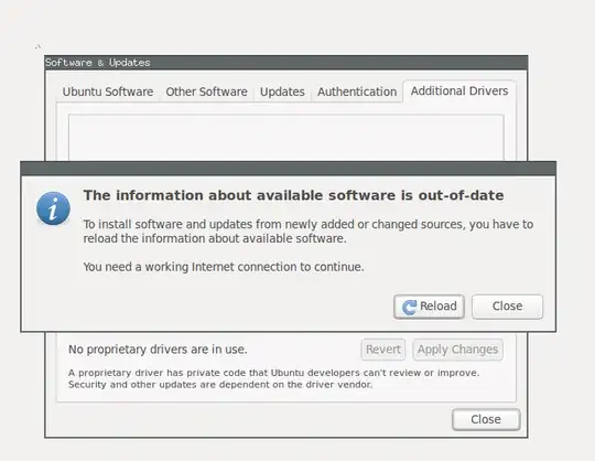

After selecting 'close' on the previous window I SOMETIMES the following message :
Information about available software
After pressing reload on that I get this error message (again, my network is fine while I'm getting this)
Fail to download repo
Here is the error message text from that :
W:GPG error: http://download.virtualbox.org trusty InRelease: The following
signatures couldn't be verified because the public key is not available:
NO_PUBKEY 54422A4B98AB5139, W:Failed to fetch
http://ppa.launchpad.net/jon-severinsson/ffmpeg/ubuntu/dists/trusty/main/binary-amd64/Packages
404  Not Found , W:Failed to fetch
http://ppa.launchpad.net/jon-severinsson/ffmpeg/ubuntu/dists/trusty/main/binary-i386/Packages
404  Not Found , E:Some index files failed to download. They have been
ignored, or old ones used instead.

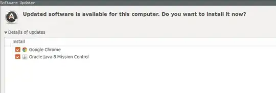

After closing that screen I get the update manager which displays the following:
Update available
I'm not sure why these are an option when the others weren't.

All the sources are commented out. Remove the "#" in front of the entries starting with "deb" in your sources.list.
