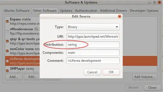

  • locate the ppa for s-lagui and click once on it
  • click the Edit button
  • change Distribution from xenial to vivid
  • click OK
  • close Software & Updates and reload database
  • if the application at that ppa no longer works in xenial, delete that ppa
