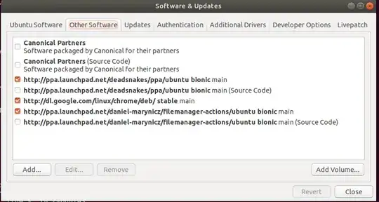

Software and Update:
Here is my software and update the latest status:

You should not use PPA to get Terminator installed. You have to remove the problematic PPA with
sudo add-apt-repository -r ppa:gnome-terminator/ppa
and then install the Terminator from universe pocket.
All you need is to enable this pocket and install package from it:
sudo add-apt-repository universe
sudo apt-get update
sudo apt-get install terminator
And then use it as was planned:
$ terminator -v
terminator 1.91
