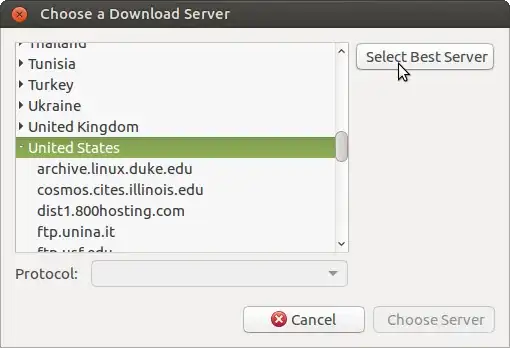

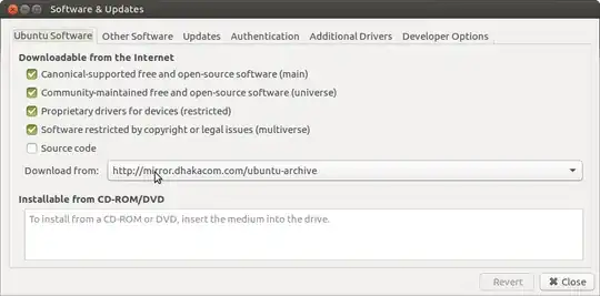

Open Software & updates
Change the server from Download from:
For best download speed choose your country or a country next to you. Alternatively, let ubuntu test and decide the fastest server by clicking the Select best server button.
