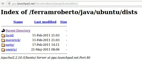

Looking in the "java" directory of the PPA link your package manager failed to find, we see:
The distribution directory of the "java" archive
It looks like ferramroberto does not offer a quantal version of this package yet.
