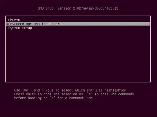

GRUB menu does not appear
If the computer boots into Ubuntu automatically without showing the GRUB menu at all, sometimes you can press the manufacturer's BIOS/UEFI key at boot time and while in UEFI or BIOS mode from the firmware menus select the operating system you need. Common keys used are Esc, Delete, F1, F2, F10, F11, or F12. On tablets, common buttons are Volume up or Volume down. During startup, there's often a screen that mentions the key. If there's not one, or if the screen goes by too fast to see it, check your manufacturer's website.*
If this doesn't work when the GRUB menu does not appear at boot time, immediately after the motherboard / computer manufacturer logo splash screen appears when the computer is booting, with BIOS, quickly press and hold the Shift key, which will bring up a GNU GRUB menu screen. With UEFI press (perhaps several times) the Esc key to get to the GNU GRUB menu screen. Sometimes the manufacturer's splash screen is a part of the Windows bootloader, so when you power up the machine it goes straight to the GNU GRUB menu screen, and then pressing Shift is unnecessary.
If this doesn't work when the GRUB menu does not appear at boot time, then try the answers to:

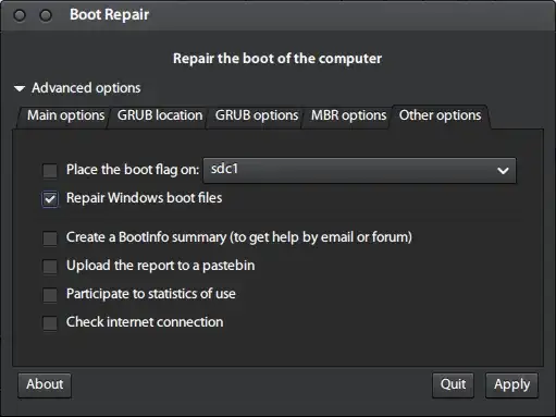

Boot Repair
From Ubuntu open the terminal and type:
sudo add-apt-repository ppa:yannubuntu/boot-repair
sudo apt update
sudo apt install -y boot-repair
sudo boot-repair
Open the Boot Repair application and select Advanced Options -> Other Options tab -> Repair Windows boot files. The boot flag should be placed on the same partition on which Ubuntu is installed. The partition on which Ubuntu is installed can be identified from the Disks application which is built-in in Ubuntu.
If you're unable to select the Repair Windows boot files option because it's grayed out, refer to this answer.

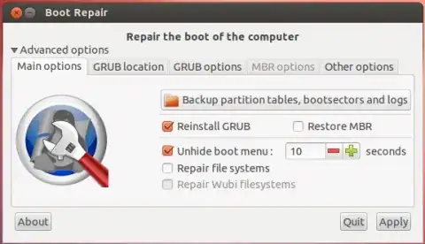

There is no way to undo the partition changes to Windows. You will have to reinstall or recover Windows, then reinstall Ubuntu.

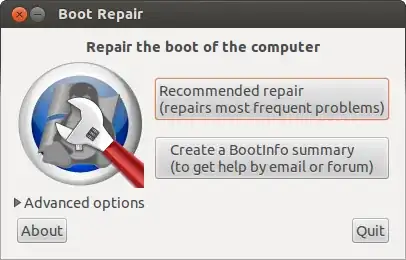

First, try running Boot-Repair(info) and see if this helps. To run this:
  1. Boot from a Ubuntu live DVD or USB.
  2. Type these lines in the terminal one line at a time.
    sudo apt-get update
    sudo apt-get install boot-repair
  3. Search for Boot-Repair in the Dash and launch it.
To fix your computer with Boot-Repair, simply click the "Recommended Repair" button. If it worked, you are done.
If Boot Repair didn't work, run a repair with a Windows Recovery CD (ask for one from your PC manufacturer).

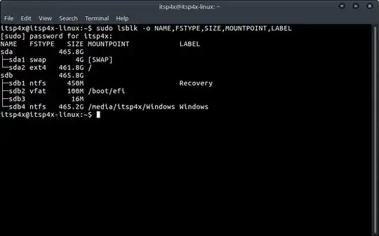

Make sure you boot in UEFI mode. Use sudo efibootmgr -t nn to utilize your EFI's menu. You can choose Windows Boot Manager or ubuntu (GRUB).
NOTICE: Windows will erase GRUB installation at its own EFI system partition each time BOOTMGR is updated.

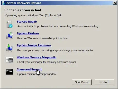

Method1
1.Enter Windows recovery mode by pressing "esc"(may be different way on your computer) while booting.
2.Click on "Troubleshoot"
3.Click "Advanced options"
4.Choose "Command Prompt
5.Type the following commands:
bootrec /fixmbr
bootrec /fixboot
bootrec /scanos
bootrec /rebuildbcd
6.Now restart your computer
Good if this works for you, if not then try

All the options that you have tried seem to be for Windows 8 in mbr mode, but you are using UEFI, so you should repair UEFI partition; when my windows bootloader got corrupted, i tried the following command.
bcdboot c:\windows /s f: /f ALL
here c:\windows is the location of the windows folder on the windows (c:) partiton.
/s is an option which allows to install the UEFI bootloader files on the UEFI System Partition , which is fat32 formatted and in my case was (/dev/sda4 ) so f:
(f: is the letter of the uefi partiton)
after this command has executed you would get installtion successful/failed
This should re-install your windows 8 boot code in the UEFI partition.
This command i had tried when booting from the repair disk and select advanced option and then command line repair.
You can create a recovery disk by by going in the control panel, and choosing backup and recovery -> create recovery disk/usb or you could borrow it from someone.
PS. If you have not already tried, then you could try all the options displayed in your grub menu, particularly refind, which automatically detects all UEFI OS. You could also try all the windows entries in the grub menu to check if any one of them works. Then you could switch your uefi mode to BIOS from your BIOS menu at system startup and then checkout what options its displaying there, and if any of them work.

Make sure that the Windows 10 installation partition is still there and proceed according to this answer:
The default installation of Windows 10 requires a minimum of 4 partitions:
  1. sda1 (Recovery)
  2. sda2 (For computers that boot in EFI mode the EFI System Partition (ESP) is normally mounted at /boot/efi.)
  3. sda3 (MSR)
  4. sda4 (Windows OS, usually "C")
If the /boot/efi partition or the MSR partition has been damaged or deleted during the Ubuntu installation, you might not be able to see Windows in grub. Try the following command in Ubuntu to show all the available partitions:
sudo lsblk -o NAME,FSTYPE,SIZE,MOUNTPOINT,LABEL
It should give you an idea of what happened to your system and allow you to check if all the partitions are still there. You might try to repair Windows with the Windows installation DVD/USB.
You can try to install the Grub Customizer application and see if Windows is available in
the list:
sudo add-apt-repository ppa:danielrichter2007/grub-customizer
sudo apt-get update
sudo apt-get install grub-customizer
Then you can launch Grub Customizer and change which operating systems are available to boot.
Here's a screenshot of what a correct installation looks like:
