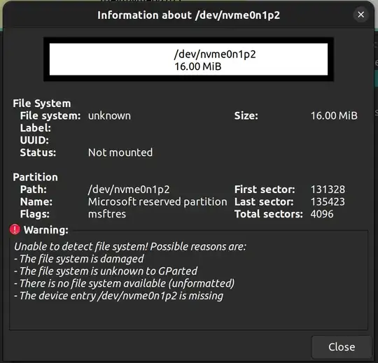

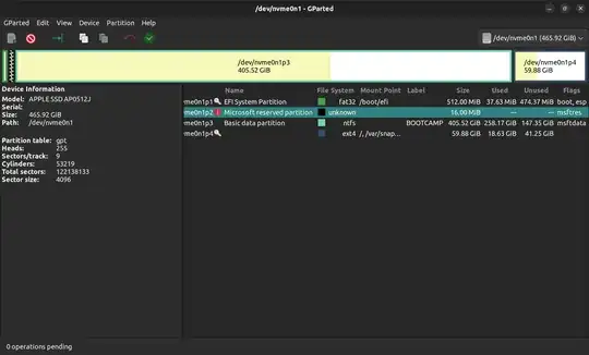

After installing Ubuntu alongside Windows Boot Manager everything seemed OK. Then I tried to boot into Windows, but I only got a black screen. I am not sure if this is because I receive an error in GParted about my /dev/nvme01p2 is throwing a warning or if OS-prober from grub is not seeing the proper bootloader as I ran Boot-Repair and it mentions.
OS1: The OS now in use - Ubuntu 22.04.3
OS2: Windows 8 or 10 on nvme0n1p3
but the Windows boot loader it attaches to says /dev/nvme0n1p1@/boot/ .

GParted errors:
gparted error
gparted info
