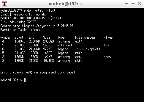

Output of parted --list
The output of the command parted --list

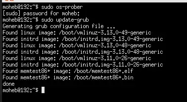

Here is the output of the commands:
sudo os-prober
sudo update-grub

Try running this command to detect other operating systems:
sudo os-prober
and then this to update grub:
sudo update-grub

I solved it by formatting my device and then installed windows xp and ubuntu instead of windows 7 and lubuntu, since lubuntu has that kind of problems ..
