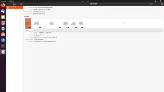

When I installed Ubuntu 20.04, after everything was done I lost my Windows 10. I am unable to boot into it and my GRUB does not show Windows 10. I need my data badly as I don't have any backup.

I hate to be the bearer of bad news but unless your Windows 10 is installed on a 2GB partition (unlikely), it's gone. Did you manually choose the partition structure or let Ubuntu installer take care of it? And did you choose dual-boot / multi-boot during the installation?
Purely from looking at your gparted screenie, I'd say you're only hope of data recovery is using disk recovery tools. Unless I'm missing something?

There are two options:
  1. Data recovery Using photorec you shall need another disk with enough free space to store recovered data.
boot into Ubuntu from USB disk open terminal and run:
sudo apt-get install photorec
after completion of installation type photorec in terminal and follow instruction from here. It is terminal command based and you can select the files you want to recover like. *.JPG, *.pdf, *.doc etc. Read this page procedure carefully before proceeding.
  1. Data recovery Using testdisk you shall need another disk with enough free space to store recovered data. Here the benefit is that you can recover the data with your directory structure and same directory/ file names.
sudo apt-get install testdisk
after completion of installation type testdisk in terminal and follow instruction from here. Read instructions carefully. With testdisk command it may be possible for you to recover your Windows partition.
