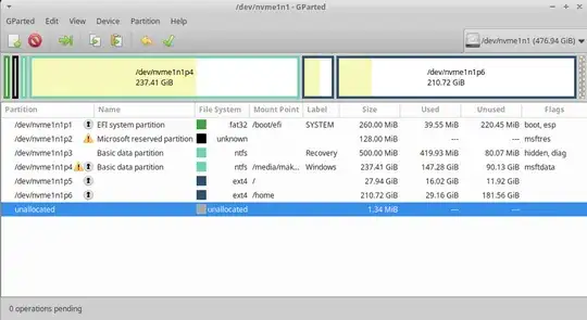

For a long while I had xubuntu and windows dual booted and I decided to reinstall a fresh xubuntu.
As a result of that I have lost write access to windows.
How do I regain access please?
Partition format

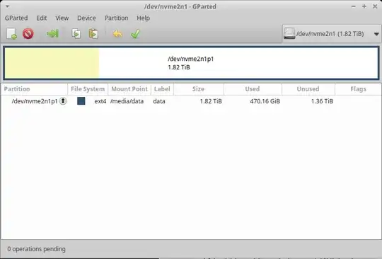

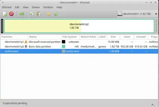

I have also lost access to 'games' and 'my data'drive in a similar way. Perhaps access can be gained similarly?
Data
data
