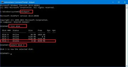

Try listing the disks active by:
diskpart
list disk
If the type is MBR, type:
sel disk C
press Enter. In this case, C is the drive where Windows folder was found. If the Windows folder is on a different drive, use that drive letter instead of “C” in the sel disk command above.
list vol
sel vol C
Type: active and press Enter
You should get a confirmation that the volume has been successfully set as active. If you don’t get the confirmation, it means that either the disk is set to GPT (not MBR), or there is a problem with the disk. Make sure you are working with the right disk.
Type: exit and press Enter
Reboot the device - you can do this quickly from the command prompt by typing:
shutdown -f -r -t 00 and press Enter
dispart-select-disk-windows enter image description here Do Not Attempt to do clean disk or convert it as it will wipe it off!
