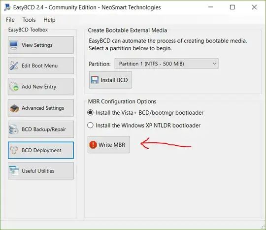

So the answer was similar to that proposed by Romeo Ninov. I installed EasyBCD, went to the tab BCD Deployment and clicked Write MBR. All of this while not having connected my external SSD to my computer. Now it is properly working.
Here is a picture showing what I did:
EasyBCD window
